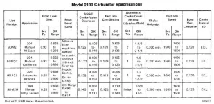

The biggest 2100 is stamped 1.33 and those are rated at 424 cfm. I would say to not go smaller than a 600 cfm, which you're just not going to find in a 2bbl, the biggest one I know of is the Holley 500 cfm 2bbl race carb.

The MC 4300 and 4350 were 2nd and 3rd generations of the 4100 and used on the AMC V8. (1970 to 1974 for the 4300, 1975 to 1978 for the 4350) I’m not a carb expert but my understanding is that these carbs are just 4 barrel versions of the MC 2100.
Go with a 2100. Closest thing to fuel injection- love mine up down and sideways. Do a little research on the Venturi sizes available. I've got a 1.08 on my 304. You can feed a 360 fine with a 2100 from what I understand. I think you'll need the 1.12 but do your homework on that.
Wooly
Yep, me, too! I've read of, new held in my hand, MC2100s at 1.21 venturi, think I saw a chart with 1.28.
I came across this on a Mustang site.
venturi size is the number in circle on side of carb .
here's a list of what = what
size cfm
.98 = 190
1.01 = 240
1.02 = 245
1.08 = 287
1.14 = 300
1.21 = 351
1.23 = 356
1.33 = 424

A smaller CFM 2 barrel carb will give you crisper throttle response every time. If I want to mud bog, I need volume, if I want to rock crawl I need good throttle response. I have a AMC 304 not a 360 but there isn't much difference. I have had s Holley 600 4, a truck avenger 450 CFM or something like that and the MC 2100 1.08 I currently run. The Holley 600 was okay on the road but a lot less responsive IT SUCKS OFF ROAD ALWAYS BOGGING AND SPUTTERING ON INCLINES. The Avenger sucked as well. I run a MC ignition with the big cap and TFI ignition upgrade the jeep hammer writes about. I think the engine may have a mild cam in it. I wheel on occasion with caveman and he can attest to the hill and off camber work we do. That combo kicks *** on and off road and I get about 14mpg. I'm running an old edlebrock SP2P 4 barrel intake with a machined aluminum adapter to the 2 barrel carb with the carb about an inch off the intake. I tried a few used 2100's then finally went with a professional rebuilt from the carb guy on eBay named ehrmannmp. It was $280. Tell him what you have and he'll tune the carb for you.
