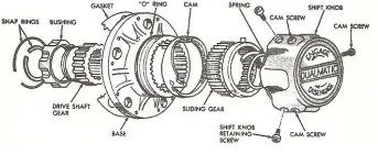

Hmm, my 10-spline (I assume) drive shaft gear is just fine. I wonder if the "base" pieces are the same between the different models, and if I could just swap my drive shaft gear into a hub that came with a different one and use it... Hmmmmmmm....
I hate to replace these hubs with something different. They are nice and easy to get to without taking gloves off...
Besides your stub shaft being 10 spline the other issue would be shaft thickness between the different hubs. It may be possible to find a selecto hub with a similar size shaft to use the base and other small parts, but why not search for a used 10 spline set they come up for sale now and then. I have a new 10 spline set in my shop I rather not part with but I may have another set in my parts bin I'll look and let you know.

Mostly interested in swapability so that I can widen my junk-finding net. Seems like the 10-spline ones are often more expensive than the ones for the later jeeps, so if I can get a cheap used one for a later jeep and make it work using parts out of the one I've got, that's a few bucks saved to pay for the next problem, I reckon. Just kind of flailing my arms at the darkness trying to keep this thing from turning into too bad a money-pit, yanno? ;)

For sale is a unused pair of Selecto hubs. 1.25 dia shaft 10 spline. They were for a early jeep.
