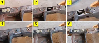

I have a stabilizer bracket that has come loose from the frame. What would be the proper way to repair a stripped nut that is loose on the inside of the frame? The nut has stripped away enough that I could get a zip disk in to cut it but what would I replace it with? Hard to reach inside the frame.

I will try to get a bolt in through a hole and get it to fall in place. If that does not work I will hole saw a hole on the side to access it.
As luck has it I was able to pop a bolt in and move it in place with a wire. I then used a magnet to pull it through the hole from the out side.
