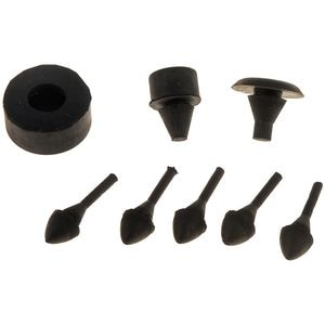

Doorman makes many different ones. Here is a example.
Dorman - HELP Rubber Bumper Assortment
The plastic ones (without a new door) are available for about $20 (Omix # 13316.01 for example). For between $AMC 150 - $200 you can get a steel locking glove box (box with door) from Tuffy (# 035-01). Like "Kingofwood" said, they would be easy to make if you have the means to make some straight bends and a few small welds. For the rubber bumpers, you can get them here: Rubber Bumper Inserts
(Link)-> Metro Moulded Parts -<
Their website won't let me post a direct link to the parts, but click on "Universal Parts" on the left side. Then "Bumpers", then "Snap-In". That will bring you to a couple dozen different choices in all shapes and sizes, none expensive at all. Pretty sure SB-36 (assorted set) is what you need, interior bumpers for 3/16" hole.
