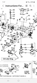

That's an auto lite not a 2100 but there close enough to the same. The rod your missing is available or at least it was at one point in time
That's the accelerator pump rod and is part # 2150-42. You could check carburetion.com (Web Site) or Mike's Carburetor Parts or salvage yards. You'll also need the clips for it.
Thanks for the speedy response guys.
It looks like that site offers a 5" and a 4.5" rod. Does it matter which length I get? I do have the tag, seemed to be off a 67' mustang. Perhaps contacting Mike's Carbs would be a good idea, I was planning to get my rebuild kit through them anyways.

I tried to see what measurement looked good by just making sure everything was seated/closed on both ends of where that rod would be. Measurement was definitely closer to 4.5.
Appreciate you looking up that part.
