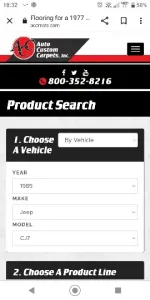

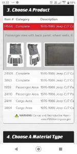

Question 2 (carpet)
Who reproduces a good quality complete carpet set? with a backing for more noise reduction?
As anyone used these companies?
(Link)-> Replacement Carpet & Vinyl Flooring - Automotive Interiors -<
(Link)-> 76-86 Jeep CJ-7 / CJ7 Original Cutpile Molded Carpet Kit *Made in USA* | eBay -<
or point me in better direction the ebay one seems pretty high priced?

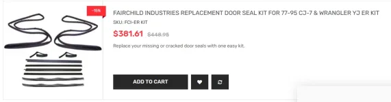

Question 3 (hard doors)
Who has a good quality door seal kit
I have the fixed vent paddle doors. I was thinking about converting to vents that open but would need new seals kit either way.
Maybe also hardtop window seals
Seems there are also people that making the piece for the door to match the top but maybe some are not correct? ( texture)

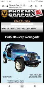

Question 5 ( decals)
Who makes the best decal? To wrap jeep
Seems they are around 350.00 and lots of people make them. Blue strips

There's a lot there I'll answer a few. As far as graphics Phoenix graphics is the only one I'd use.

Although I've never used them for Jeeps (only muscle cars) try pui for carpet

Here's some screenshots b6266e7fd867e4faee801f792cae4c04.jpg1d2393aa21ae9219d62151649ff1e4aa.jpg96bff4f38ce75d0305e4742376fe90dc.jpg

Door Seals:
I used the Crown Automotive seals to rebuild my older generation doors. The only thing I couldnt seem to find at the time was anyone that had the vent glass seal. As far as the crown auto seals themselves were, everything fit as it should and was either sold as one big kit with pretty much every seal in the jeep down to only the ones you need. Price wise the kit was the way to go for me as I needed way more than the doors. My jeep hasnt really seen much use and abuse or time outside since I have been rebuilding so cant speak to the longevity of the material yet, seems like decent quality.
I was looking back to see where I bought mine, cant find it but pretty sure I got it from JustJeeps.com in Canada.
I did see this kit on their site when I was checking, no vent seals.. sold separately but they do have them as well in the Fairchild brand.

Question 3; hard doors and vent windows. The fixed window seals are not reproduced by anyone that I've ever found, and I've looked for 10+ years. Swapping them to movable vent windows is not a simple process, it involves cutting the doors and needing to add a rolled seam.
I couldnt find the fixed vent windows either but it seems here they are > (Link)-> Fairchild Industries Vent Window Seal for 72-86 Jeep CJ with Fixed Windows D416- -<
BTW - removing and replacing these are not an easy task and you need strong fingers, lots of soapy water and patience.... and of course a rubber mallet :)
