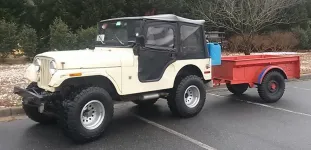

I'm a bit biased here, but the '66-'71 V6 powered CJ's are pretty great! Mine thru the years... I rode home from the dealership in Seattle with my dad on my 6th birthday in December 1970. Learned to drive, dated, Navy moves, married, three kids and now grandson have all been part of its history. Daily'd it for MANY years in Wa, SoCal and Virginia. Like I said, I'm biased...:chug:
