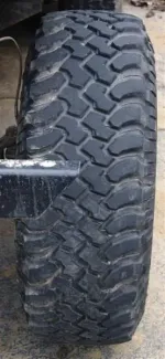

Although I run bigger tires I have a similar story. I had 35x12.5-15 BFG Radial tires and replaced them with SuperSwamper SX 36x12.5-15 Bias Ply tires. I made careful measurements to make sure I could accommodate tires that were one inch taller (half inch bigger radius). But where I had problems was the width. Both tires were 12.5 inches wide BUT that measurement is only for the tread. My new SuperSwampers were Bias Ply and the BFG were radial. The Bias ply bulged out much more and now I need wheel spacers.
Here is my old BFG radials.
Here is my new SuperSwampers:
I have the SuperSwamper SX and you plan on getting the TSL so we are not talking about the exact same tires but I still think the width will be a bigger issue than the diameter. You should be fine going to 9.5 inch wide but don't always trust the numbers. They are deceiving when going from radial to bias ply.
