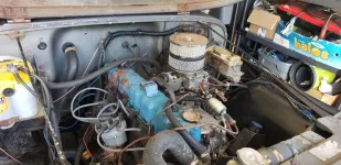

The YFA carb was able to get it running but not well so I rebuilt it and did a “Team Rush” ignition upgrade using Ford large cap parts. Our club Novice run was coming up so I went ahead and went through the brakes and tossed on a new fender to replace the mangled one. It still had the original 78 series spare tire but some 30x9.50 tires on the ground. After going through things it ran really well, drove nice and went on its first off road trip.
I found the torque of the little AMC 232 i6 to be great on the stock CJ. The carb was not too pleased with inclines but it got everywhere it needed to and was a blast. Wheeling stock rigs on novice runs has always been fun to increase the difficulty of the easy trails. At the end of the day I did break away to head home early but took a short cut across a trail. Ended up flexed out across a washout with a rock hung on the back side of my Transfer Case skid. Knowing it had a factory Limited slip I tried the ol’ brake and gas maneuver to try to engage the stopped wheel until the little torque monster twisted the front driveshaft in the center. That was the first I had seen that happen.
