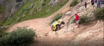

Thursday August 17, 2017
Poughkeepsie Gulch & Corkscrew Pass
Last night, our youngest son, Matt, flew in to Montrose to join us for the last 2 days of trail riding. This was his first time wheeling. His reaction? He plans on joining us again next year!

JR74 taking the middle of the wall
