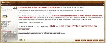

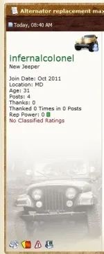

infernalcolonel, when you created your account (18 days ago), you agreed to terms and conditions of using this site. One of those terms was this;
attachment.php
Which you obviously have not done;
attachment.php
It makes it easier for the other members of this site to answer your questions when we know what kind of vehicle you have.
