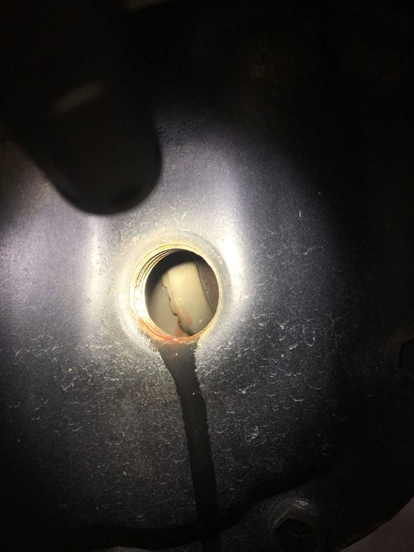

New CJ owner here with a couple questions. My rear differential is leaking oil. Picture attached shows amount of oil after two days of sitting. Im going to remove the cover to drain the oil and to also see what type of locker i have in there. My concern is resealing the differential. Im assuming a gasket is needed, any suggestions on which one?
also, would it be worth adding a stronger differential cover while i have the stock one off? The previous owner thought there is an aussie locker in there and it spins both wheels same direction when the rear is jacked up.
one more question. are those welded on supports above the axle housing stock or added later? thanks

The welded things are axle trusses and they were added by a previous owner. The axle tubes are also probably welded and the next logical step he probably took was to replace the two place axles with one piece. You can check this by looking at the axle ends at the center of the rear wheels. If there is a cap then the axles are two piece and if they are flat they are one piece. I wouldn't worry about the diff cover. Replacing it is not necessary for strength.
Check to be sure the cover bolts are tight.
When I have rebuild any mod 20 rear. I use RTV silicon sealer and no gasket. Never any issue. Let it sit for 24 hrs before adding oil.
LG
For a stronger rear diff cover, I would suggest something made from a stamped steel and not a cast material as they can break. I like the plan for a stronger diff cover as it can give a bit more protection in the rocks. Lumpy's way of not using a rear gasket has worked fine for me also.
It's not leaking, just marking it's territory😁
I've used black rtv on mine and customers vehicles for nearly 2 decades, no need to waste money on a gasket that can't be reused.

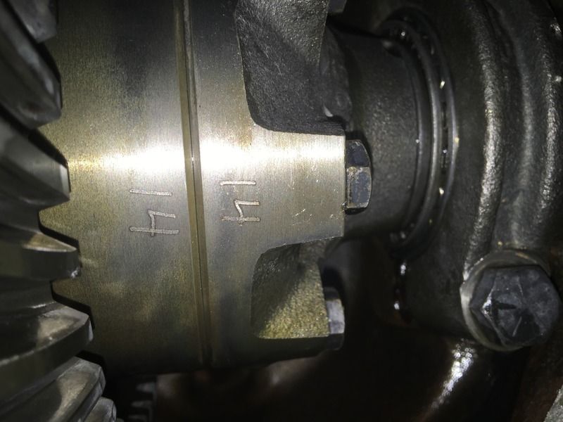

I did indeed have some sort of locker in my rear differential, not sure what kind.

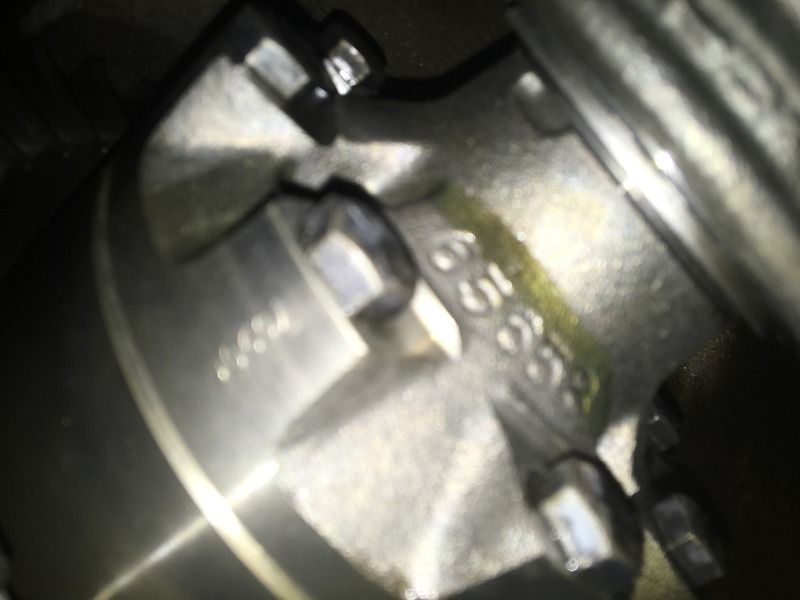

Can anyone identify what this is?
That looks like a Detroit Locker. Can you find any ID numbers etc. Is it closed up all the way around?
DL's are the K.I.S.S. of lockers. I run'em front and rear in mine.

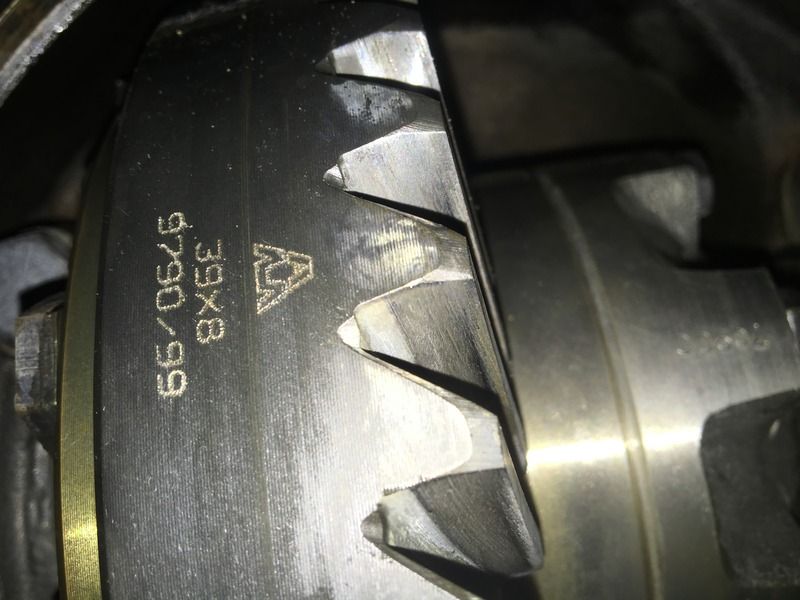

Do you know the R&P ratio?

It is solid all the way around. I'll see if I can get some ID numbers off it tomorrow before I try and make my first gasket :-)

What about the ratio?
There should be markings on the outside of your ring gear. Get a picture of those and we can tell you what you have.

Looks like a Detroit from here. The kind you don't want , the kind you ship to a guy in Pa. Nice find.

4.88

YUP-4:88. I run that with my 5 speed.

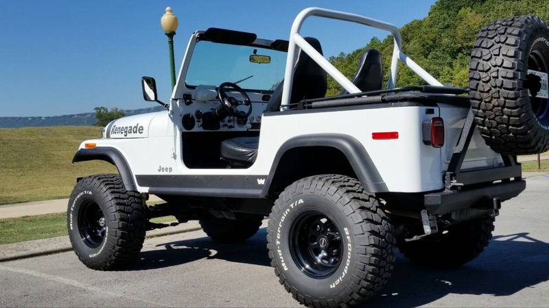

What size tires are you running?
LG
Same size I run in tires.
You should be fine. That 4 popper likes some RPMs to run.

Could be either an 'Aussie' or a Lock-Right.
The weakness is in the carrier.

Can you tell if that's a 4 or 2 inch lift?
