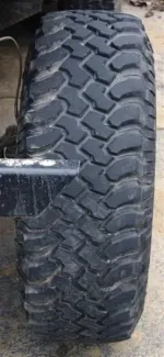

Here's the radials I used to have:
Then I got bias ply that were supposed to be the same width.
Look at the springs. They now rubbed my tires and I got wheel spacers.
You can see the bias ply have more sidewall bulge
I assume you are getting radials. They might not rub.
But then again you have narrower rims (mine are 12 inches) so maybe yours will rub. Sorry I don't have a definite answer but I bet they won't rub. Yes, that's my final answer: they won't rub.
