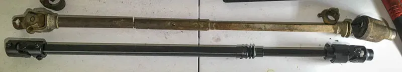

Welded steering shaft.
I...I guess I should have looked closer.
I'm gonna pull it out and see if I can get it to telescope and maybe put a nylon pin back in.
Sounds like I'll have to pull the column, too...

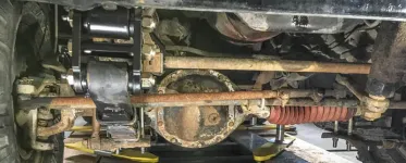

We really need to see some pictures from the steering box and linkage etc.
Do you run a dropped drag-link?
If so-Might be binding and such now.

I couldn't cut the weld without getting to the point where it seemed unsafe, so I cut the shaft off and will replace it with a Borgeson 000910 (unless someone sells me on the 000920 "vibration reducer").
I'm in for a penny. I also plan to replace the shaft/column bearing by the firewall (Crown was the best I could find), the the wheel turns pretty smoothly. Anything else I should be doing while I'm in here? Do I need to save that weird joint and housing on the steering box end, or does the Borgeson shaft replace it?

I threw some paint on the new steering shaft, cleaned up the teeth and slathered them in grease, manhandled everything into place. It took some effort to get each side of the shaft onto the teeth. I found it best to line the set screw up with the flat spot, get the shaft positioned correctly, then whack it with a rubber mallet to actually push it on. For the top, I got under the car, straightened the shaft as much as I could and whacked. For the bottom, I lined it up as best I could and whacked the coupler, 'cause it was the only place I could find purchase.
There was some trepidation about the set screws coming loose, so I tried removing one to add thread locker and it was damn tight so I left the rest alone.
The bushing/bearing from Crown looked identical to OEM. I spoke with someone at Willys Works and they said the only one they had was the Crown. I squeezed a bit of extra grease in them, lined everything up in my hands before putting it on (the orientation of each part is a bit confusing), then got it all on with a big socket and some light taps.
Steering feels as good as ever. It's still a bit too stiff to return to center on its own, so maybe I'll replace or rebuild the steering box down the road (quicker ratio?). Right now, everything feels pretty smooth.
