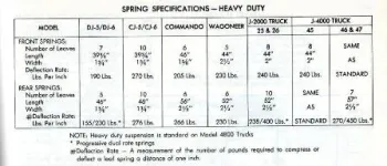

Here is the data from the factory manual with the spring rates. The spring rate is how many pounds of force does it take to compress the spring 1". There is a lot to the spring metallurgy. Some springs can bend flat or more, some will break if they are loaded to flat.
Rancho catalog lists the YJ 1-1/2" and 2-1/2" lifts at 174 lbf/in front and 200 lbf/in rear.
The OME YJ springs I used were 148Lbf/in.
The specs are usually in the catalogs, but you may have to dig.
