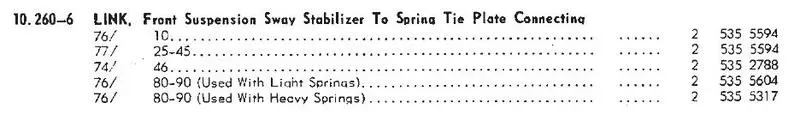

We are changing out the bushings in the front springs and swapping out the sway bar bushings while we are at it. The front springs went fine. I went ahead and ordered the new sway bar links since I couldn't see where I could order just the rubber. I noticed the new ones I got were much longer than the old ones.
The jeep has no lift with what I am assuming are the stock springs.
There are 2 (3) types of stock springs, light, HD, and XHD.
Seemingly the use different sway bar links:
I have an XHD suspension (factory) and mine has the long ones...
In fact I would not care about the length...
