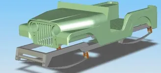

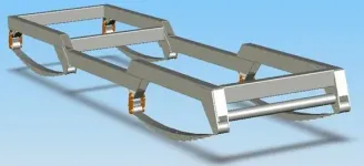

so far my build plan when i get to it is going to be building a square tube chassis cause this one has been broke and re-welded in a couple different places. fix the body, cut out rust and weld in new metal. build a full cage out of real tubing instead of the "example of structural engineering" thats in it now. ideally id like to add a 4BT but i dont have the cash flow for that so ill probably just freshen up the drivetrain thats in it.

ive heard that some of these measurments are off but when i do mine i will have the tub off so i can double check things.
