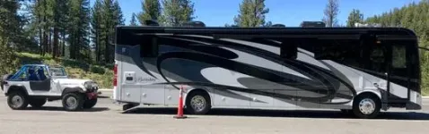

Transfer Case in neutral, steering wheel unlocked (turn key one notch and leave key in), Transmission in park (auto) or in gear (manual). I use a driveshaft disconnect because I tow on a regular basis behind a motor home. According to the owners manual it’s not necessary if you stop every 300 miles and run the motor to keep Transfer Case seals lubed. Removing the rear drive shaft is a good option to be safe. Good luck!
What kind of tow bar are you using?
