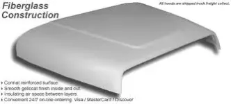

Can anyone tell me or give me any information on how to distinguish a YJ from a CJ hood or if it is a CJ but if it is an aftermarket hood. I have somebody who is willing to sell me a hood but he does not know any information on the history of it and is unsure if it is a YJ or CJ. I just wanted to try to make sure before I drive an hour away that I'm not going for the wrong itemhttp://http://lakeland.craigslist.org/bar/3580956275.html
Looks like a Cj hood to me. Note the narrow impression , Yj is a little more square as well.
Yj hood:
Cj hood
