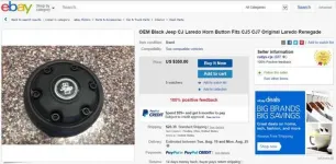

Not bad $, but for cars.
I was looking for a leather wheel (on e-bay) for my Laredo #1, and found picture #2, said dang mines better, then I found #3 and thought mines good enough $. Almost as crazy as General Ikes $750.000 MB in/from Scotland or was that 450k either way crazy $.
Still haven`t found a good $ wheel (or someone to wrap) so will use one of my others until.
