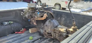

What I bought in Odessa TX, dragged home Jan 10th during a W Texas snow storm to Fort Collins CO

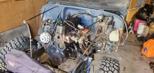

Old motor ready to come out!

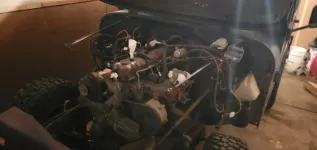

OH NO, a dead Jeep and 2 engines. This is definitely the point I felt most pressured to succeed!

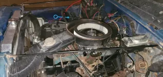

New motor in with manifolds mounted!

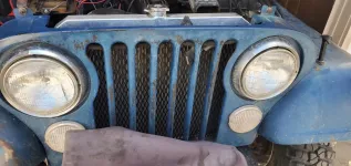

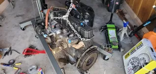

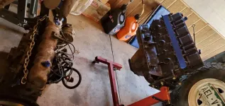

I added a grill screen while everything was apart. A strong screen that did cover my slots has been on my list since 2 years ago when a TWIG poked my OEM rad.
