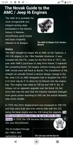

BTW stock AMC 258 i6 / 4.2l is rated @AMC 150 . horsepower and 240 lb-ft of torque
Just looked at what they're offering. It's really over priced for that. You could build your own using your block plus an aluminum head for less than 10k and have a better engine. Parts around 5k 3-4k at the machine shop and can be done locally to save on shipping.
Good info. BTW, I'm not sure why we have different power/torque specs. I'm looking at a chart from ProfessCars supposedly based on factory data. Showing peak HP at around 98HP at 3000 RPM and peak torque at around 190 ft-lb at 1500 RPM. What are you looking at?
