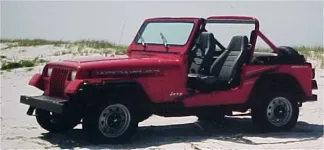

The picture that started it all. This was the printed picture from the ad where I found the Jeep in Roseland La. Flexing on a rock in the front yard back when I use to daily it. Then finally right before I pulled it into the shop to take the body off. It had a dry rotted flat tire, coke bottle for a fuel tank, and would not stay in gear, but it got in there to the amazement of a friend of mine. The YJ I had before I came to my senses and got a CJ. And my Willy's showing some flex on the ramp we built.
