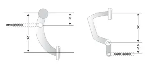

Am I missing anything on the brake conversion?
Yep............your pedal set has a different pedal ratio ( about 6-7:1 on manual ) VS what you need for a power boosted system which is about 5:1. To much leverage and the brake pedal becomes touchy when applied........
Some brake pedals did have the second hole while others did not......but the offset to correct the ratio sometimes gets the push rod between the pedal and master cylinder running at an angle which is no good either...
Adding the booster may also sometimes requires a linkage adapter between the firewall and booster for clearance at the firewall and in some cases the offset linkage will correct the pedal ratio inside............
Jeep had a special way of mixing parts.............Get out your tape measure and check your current ratio...and if you can find a similar year model with OEM power brakes , take a look under the hood and see if an adapter was used.
