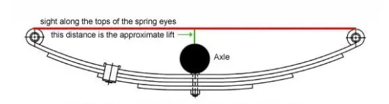

This is the easiest way to figure how much lift you have
What you are saying is that on a stock spring the tops or the spring eye will be flush with the top of the axle??
Hey thanks for the picture. I found an extreme 4x4 shop here in town and the guy there gave me great advice. The picture of the spring is similar to what he said. Thanks that was smart advice. Hey cj relax I was joking so sorry for you, that you didnt get the humor. Your advice was also given to me but as stated it was risky and somewhat dangerous, not smart. ha ha But thanks anyways. Also in jeepfourm, not jeep-cj fourm they suggested the measuring of the spring travel also, smart and safe.

I had to try this today, here is what I found. My 4" lift only measures app. 2" to the top of the axle, 4" to the bottom. (front axle)
It is getting old and broken in but I don't think it's settled that far.:eek:
