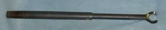

Grunt -
As yellow85cj said, it looks like the steering shaft has compressed. The internal shaft is in 2 pieces (see attached pics) and is meant to collapse during a collision. Once the plastic rivet that holds the 2 pieces together shears off, the upper part of the shaft slides into the lower part. Everything I've read says the shaft can't be repaired, it needs to be replaced.
Hope this helps, Bill
You can drill out the plastic and put a nylon bolt in it. Or get out the welder.
