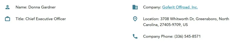

here's some useful info
tie rod flip
I saw that on a search but the problem is I cannot find goferit. I thought it was goferit.com or goferitoffroad.com but neither are loading a page for me to purchase. I would be good buying them from goferit but not so keen on purchasing from random amazon chinese knockoffs. If theres another USA brand one I would be good with that too of course.

not sure how up to date this info is
