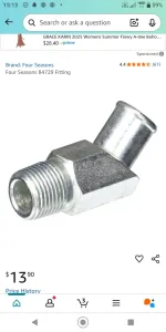

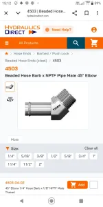

This is about the height your looking for and fyi that front hose bib should be like a 45⁰
They do make a hose for that. Where my finger is, is where I have released air from the system by just loosening the clamp a little and tug the hose a little and air has escaped a couple of times I have done something with the radiator. IMG_4119.webpIMG_4118.webp
