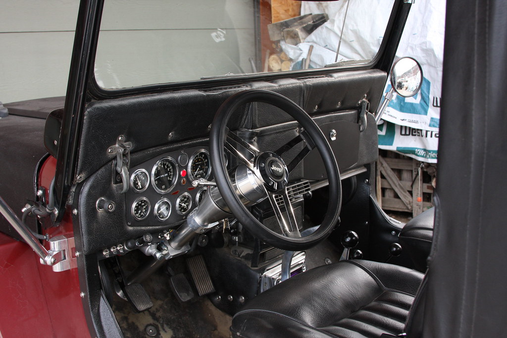

That is what I used in my 3B, minus the switch. Zero problems-well maybe one. Save your money on the dimmer switch option for the wand. Those don't have sufficient clearance for the wires at the base and eventually short out. I did use Flaming River's electronic dimmer unit and that works well. Currently, that is wired up to both a floor switch and a dash switch. I made a clamp-on housing for the ignition switch.
Thanks, that is what I am leaning toward, Is that a Grant steering wheel?

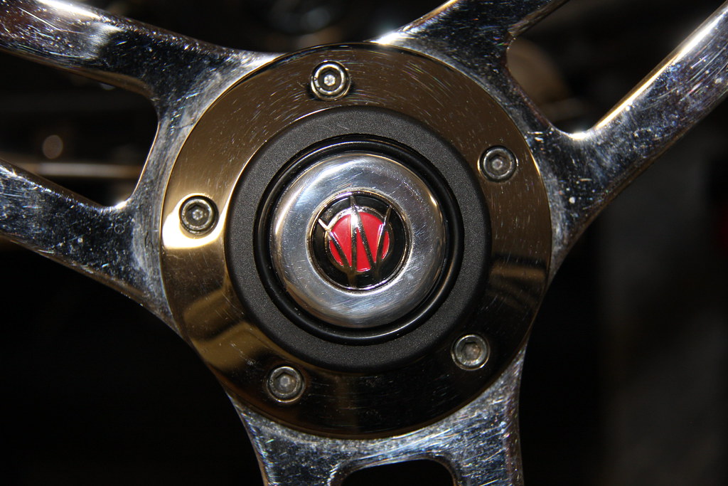

Yes. I ended up eventually machining out a new horn button for it.
Thanks, is the material on the outer ring holding up ok?
Yes. Still looks new and I think I purchased the steering wheel in 2008.

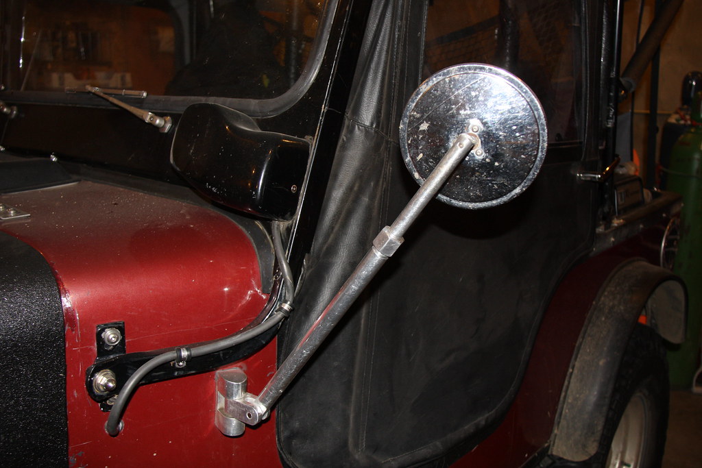

duffer, the gauge relocation behind the steering wheel is great. Do you mind posting details about the sidemount rearview mirror…
Those will be difficult to obtain. I made them from aluminum. Excuse the bug guts---
Those mount in the stock position on a flat fender. If one is keen on boredom, there are quite a few photos of that Willys here: (Link)-> 1955 Willys CJ 3B -<
