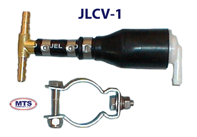

The plastic check valve does come apart for an inspection and operational check. The metal one can rust up so you could check its operational condition. there are a few similar units available online so check that, along with the big box 4wd parts outfits. I did replace mine with this one:DeLorean Motor Company - ROLL OVER VALVE.
