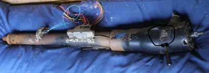

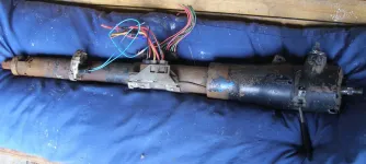

I bought a 1979 jeep j-series truck tilting steering column from our local junk yard..
Problem is it appears to be missing a couple of things. I have all column shifter levers (have the hazard button and turn signal lever) but looks like its missing the key release lever? (I do have an extra too.. But can I install a non-tilt release lever into a tilting column?)
Please check out the pictures and let me know if anything else is missing....
Was hoping this would be an easy fix and fit in my CJ7 jeep.. But I guess not.. :(
Splines look the same as well as the length. Anyone have experience with installing a jeep j-series truck tilting column in CJ7 jeep? As I just want to make sure it will fit in my CJ7 before I rebuild it for nothing. :eek:
I currently have a non-tilting column installed in the CJ7 that I rebuild and it works fine but, after I bought a new seat, my legs now sit too high so I touch the steering wheel with my knees when I try to hit the brake. I have the seat adjusted to where I like it too.. :confused:

I think I would start with using a tape measure and counting those splines just to make sure. Checking out all the wiring for the conversion and removing your existing shaft for a dry fit. If it fits you could even hook it up to see just how it works.
Re: Will a 79 jeep series truck tilting column fit 76 CJ7 jeep --& what is missing on
It looks like it's missing the auto Transmission shift lever, the raised area circled with the pin holes.
It's also missing the shift indicator dial assembly which mounts directly on top and is circled also in your picture.
Any key release lever would be mounted under the ignition switch so one hand operation is possible (I think).

Oh Snap! That is what I feared... So, does that mean probably not a good tilting steering column to use?
I'm wondering if a 70's gm steering column would work?
Perhaps I should go back to the junk yard and trade this one out for a gm steering column? (My CJ7 is an automatic floor shifter model)
If the gm tilting columns won't work, would another vehicle (besides cjs and yj as we have none in our local junk yard) have either a tilting column that will work? If not, I will get "in store credit" for $52... Perhaps I could locate a rear tire swing out bumper, or just the carrier?
I also need the drivers seat riser that folds forward... But don't know of any gm or other amc vehicles that has that specific bracket...
Thanks for your input...:notworthy:
