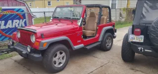

Just picked up a 98 Wrangler TJ 4.0L auto, wife claimed it and wants either another CJ conversion, or is seriously considering having me do a YJ front clip which she is leaning real hard towards...talk about pissing off the guys in the TJ section of the Wrangler forum :LOL: :banana:

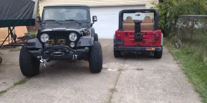

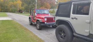

The 98W looks small next to the other Jeeps. Probably just the angle.
Nope, not the angle, wife and I laughed our butts off when comparing the 98 to the 99, looks like 2 different makes, not the same Jeep lol.
