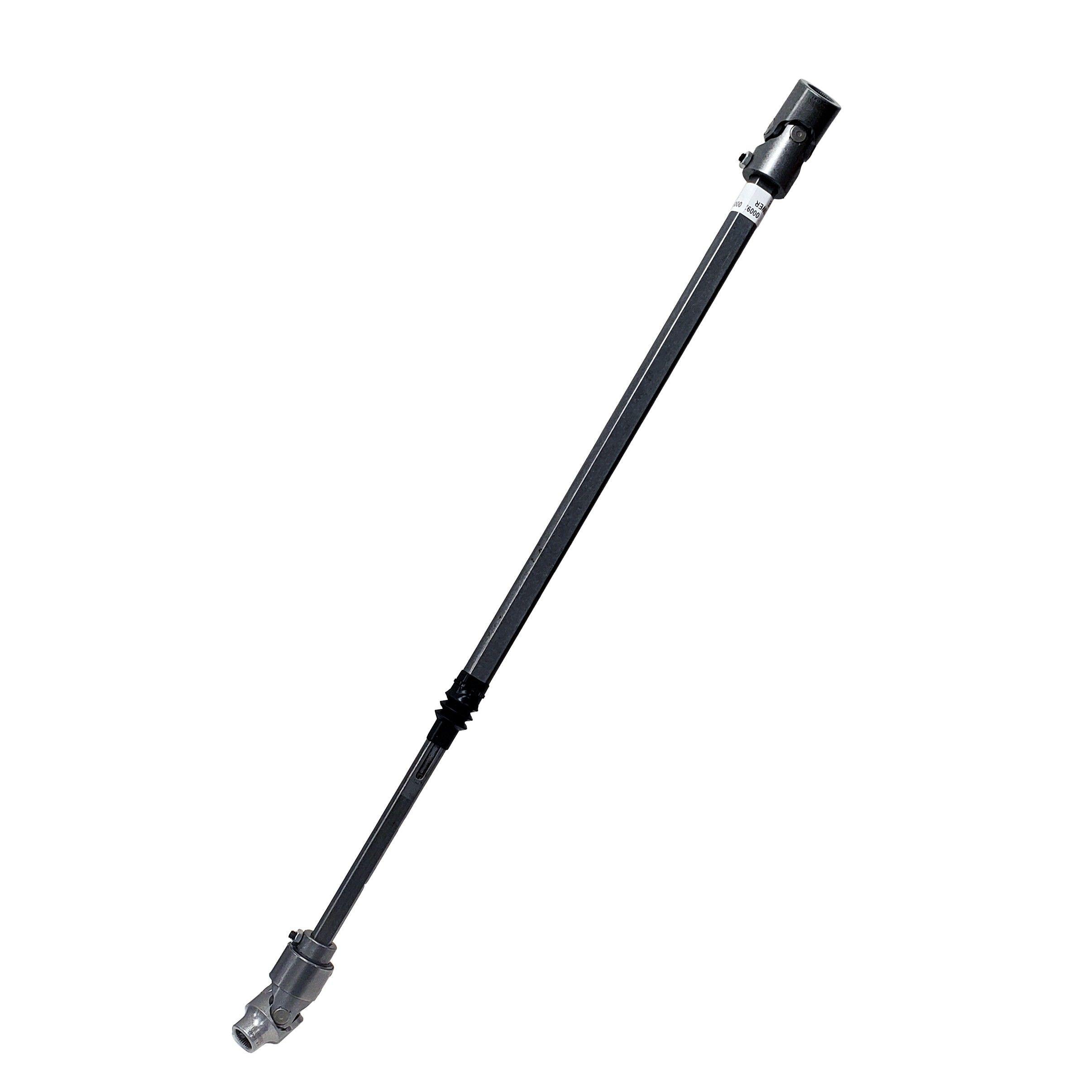

Not sure if you've considered a new lower steering shaft yet. There are a couple different options out there, but a collapsible shaft with u-joints on both ends is a good upgrade and can eliminate some looseness in the system.
I ordered new differential gaskets today and plan on opening them up and inspecting, and fresh oil. Not sure how to tell which one I have but it’s the AMC20 real and Dana 30 upfront.
Please send recommendations on steering shaft so I can research.

For lower steering shaft, look at Borgeson
Or
Flaming River (Link)-> FR1519-PTLT - 1972-86 JEEP CJ5 / CJ6 / CJ7 / CJ8 Slip Shaft Kit - Fits 1" DD Column w/Power Box -<
