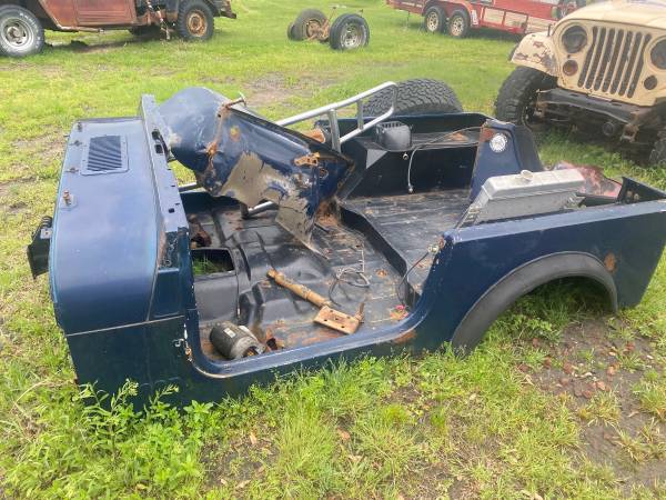

Another couple of weekends down and some progress has been made. The tub is off, that was a mess. I think I only have two tub bolts intact, lots of grinding and cursing. I joined a local Jeep group on FB and managed to score a tub (lost a day running down to pick it up but that's okay). It needs a little bit of work but nothing like my original. With the tub off, I have removed all the rotted brake and fuel lines, dropped the tank, pulled the exhaust, and removed the old shocks. Ready to pull the engine and drop the axles next.

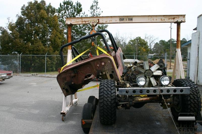

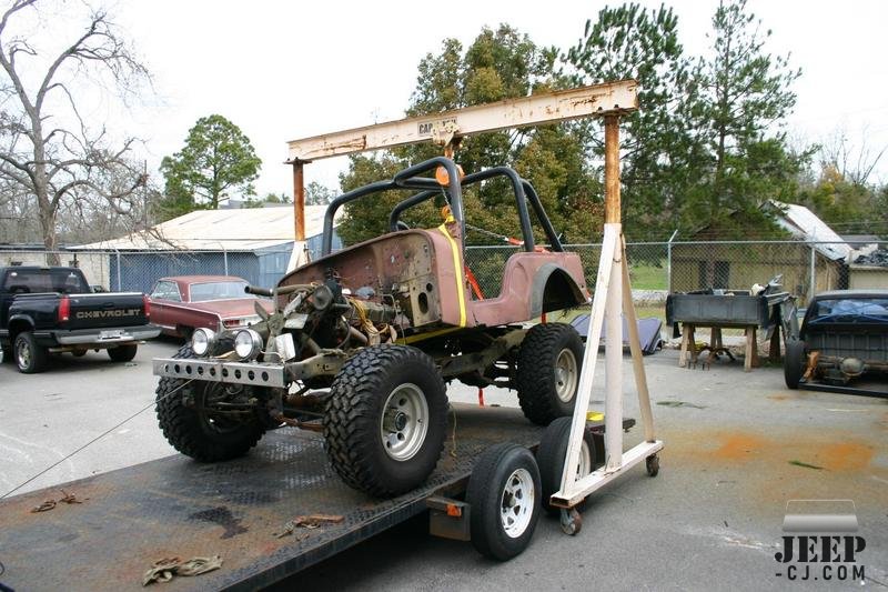

Another weekend down and a little more progress was made. First off, I built a 'ginormous' gantry to pull the engine and use later for flipping the frame and setting the tub. When this project is all done, I'll have a place to hang a porch swing!

Very cool 😎 👍. First wooden A-frame I have seen for auto work! Two more thumbs up 👍 👍.

Thanks. I started looking for a cherry picker but realized I would like/need a little more than just a way to pull the engine. Including the chain hoist, I'm in less than $200. Once the pressure treat has a chance to dry out, I'll slap a coat of paint on it, and we can use it for anything!

I got the drive train pulled on Sunday, found a mouse nest in the bell housing and learned that the casters on my gantry are not big enough to roll when the ground is soft. 🤣🤣
