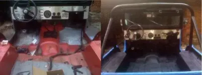

The first mod was replacing the dash board and windshield and floorpans to get rid of the rust. Next I did the bedliner:
