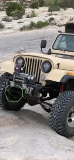

I didn't do the go fer it kit i went with this kit https://ok4wd.com/rock-equipment-tie-rod-flip-kit some people think this kit would be easy to mess up but its very simple.
Oh yes the pitman arm can go back to stock. Im running a drop pitman arm but plan on installing a stock one soon.
