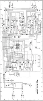

Yes.. If you look at the oil pressure sending unit there should be 2 things hooked to it. A 2 or 3 wire plug and the purple wire. The purple wire should have a 90 degree connector on it and plug into a singe screw looking pin.
I double checked the wiring diagram. Purple is for the oil pressure sender.. Purple with tracer is for the temp sensor.. I thought mine was red or green.
Jimbo, could you possibly get me a picture of where that oil pressure plug is supposed to go, it is with i believe with two red wires that plug into somewhere by the passenger side in the back but the purple wire wasnt pluged into anything and the oil pressure looks like its working fine
