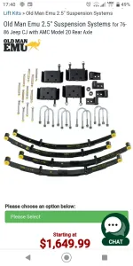

Yes there is a complete kit for the YJ conversion and I prefer old man emu. They make quality products but it comes at a cost which is why I haven't done it yet (keep in mind I said yet) the YJ springs are somewhere in the neighborhood of .25-.50" wider than CJ springs so they provide a smoother ride quality over CJ springs even more so with worn out CJ springs.
Ome typically has some sort of lift as they are designed and built in Australia for use in the outback. I believe they're smallest lift kit is 2" but don't quote me on that. Price varies depending on options from light duty (basically stock to heavy duty meaning you have a ton of :dung: hanging off the Jeep adding weight) most people don't realize this and get a medium or heavy duty setups then complain about ride quality as they bounce up and down the road.

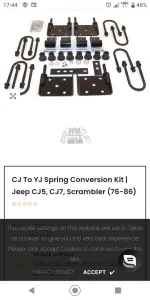

BDS makes a kit for this conversion. It includes new shackle hangers (since the YJ springs are 2.5" where the CJ springs are 2"), mounting plates with u-bolts, and hanger bushings. You add your desired YJ springs (stock height or lifted), spring bushings and shackles. You grind off and drill out the rivets holding the existing hangers, bolt/weld on the new ones, the front hangers are moved forward one hole length, and then install the new stuff.
YJ Spring Conversion Kit

YJ springs = YES (with issues.). More difficult than stock type but superior ride and flex. Much newer design. The there are many ways to go. OME is great but you have to piece a kit together if you buy individual parts or you could go kit form from RRO here.
I'm pretty sure ome has a complete kit just pricey
And this if you want to piece it together cheaper
Sent from my E7110 using Tapatalk
