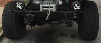

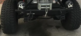

Hello, new to the forum and seeking out my first CJ. I’ve located a clean 85 that has my serious interest. It has a Dana 44 front that has me stumped. The front leaf hangers have been relocated to the outer frame. I’ve researched this mod and I’m comfortable there. It’s the steering linkage, tie rod specifically that has me stumped. It’s not the typical straight tie rod, it’s curved or should I say contoured in shape. The geometry seems odd. I’m looking to see if anyone has seen one of these and can share their knowledge/input. Thank you.

The tie rod shouldn't be like that. I'm not even going to try to guess why it's like that. It should be straight. Some times they bend them at the factory to get around the gear cover but this doesn't seem to be the case.
:agree: Kind of looks backwards in design, if it even is by design. Seems to deliberately put the linkage in harms way on the trail. I would replace it with a correct linkage.
Agreed - looks odd for sure. Is it mounted on top of the steering knuckles or in the factory position below them?
Wooly
That looks to be a wagon tie rod they have a bend in them, but that one looks like it got hung up on a stump and bent out of proportion and mounted on the bottom of the knuckle arm.
Top one is a wagon TR
Normally you will see the Drag Link coming from the Pittman Arm in front of the Tie Rod not behind it..........the PO has it reversed for some reason..........
The front axle with forward mounted shackles under compression will move forward up to .750"...........hence the reason the Drag Link normally gets mounted forward since it's stationary to the frame. As opposed to the Tie Rod being fixed to the axle and traveling with it............
I would be more interested in seeing pictures of the spindles and steering arms which will probably lead to the reason why it has a strange steering configuration.

Agreed. It almost looks like it on top of the arms but hard to tell from photos provided.

That setup is fine. Very heavy duty, and those bends are there to give the Pittman Arm room to swing.
Confirm that T-rod is solid bar and not hollow tube.

YES-Please enlarge each pic of the OP's and I think you'll see what I'm see'n about the clearance deal.
Those bends are to equal and uniform, IMHO to be from an impact. I wonder if the T-rod should be turn'd up 180*??????????:confused::confused:

Still looks really weird to me - looks like it's at 45 degree angle from about the steering box up towards that daylighter.

Agree-Those bends were put in by a tube bender and both sides look the same. :confused:

And it looks like it's on top of the steering arm which is causing such a dramatic bend perhaps????
Wooly
Like maybe they drilled the arms to put it in top and then realized it wouldn't fit under the steering box etc.

I can see the OP has the TR mounted on top of the arm. One bend belongs the other bend to the driver side does not IMO.

Here's two photo's showing the tie rod end on each side. Tie rod is mounted on top. I agree with Lumpy Grits, the bends do appear intentional but still weird. Woolyworm mentioned the arm may have been drilled for a top mount. If this was done are new arms need to put in a straight bottom mount tie rod?
I appreciate everyone’s input on this steering linkage issue. I haven’t pulled the trigger in making this CJ mine yet but I’m really close. It’s got the heavy hardware I’m looking for, I just want to know what I’m getting into here as I’ve never seen a tie rod like this. Also, no steering stabilizer, sloppy steering.
It's a Dana 44 , I guessing from a wagoneer, CO/PO has no input. Five bolt lug pattern.
