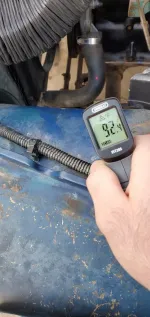

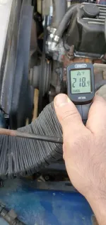

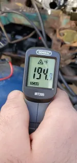

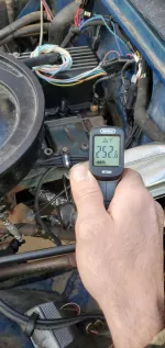

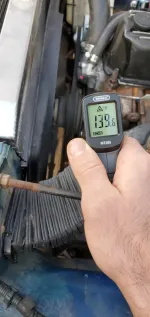

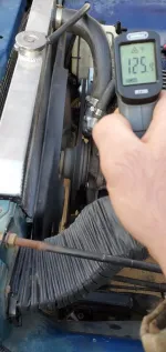

Here are some readings
temps don't look bad

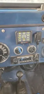

I like it a lot so far but have not driven a whole lot, great throttle response in town and not bogging down like a rich carb. I do think it can run leaner, but I am at altitude. I just noticed on my test drive yesterday that the A/F ratio spent some time below 12- 13 when I was on the throttle so I am going to play with that now that I think this temp issue is resolved. I'm not a great fan of the touch screen, but the interface with all guages one one screen is great, and redundancy for the temp never hurts!
