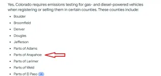

So I was told I need to pass emissions to get plates, I failed big time with my carb system. With no ERG, will that affect it?

1) Ahh, parts of your county require testing... :(
2) Since you have smog testing leave as is.
3) Your CJ originally was equipped with a computer controlled carb and that is why your down pipe has an O2 sensor.
To get your Jeep smog certified may be a crazy pain depending on CO's requirements. You would never be able to in CA as they require all original equipment or CARB certs.
Does CO require just a sniffer test?
Per CO - (This may apply)
Vehicles 1982 and newer are exempt from emissions testing for seven years based on their model year. After the exemption period, vehicles 1982 and newer must be tested every two years, and vehicles 1981 and older must be tested annually. The registration renewal postcard will indicate if an emissions test is required.
Do you have any friends or family that live in a county that does not require testing? It may be less hassle to take up temporary residence if so ;)
