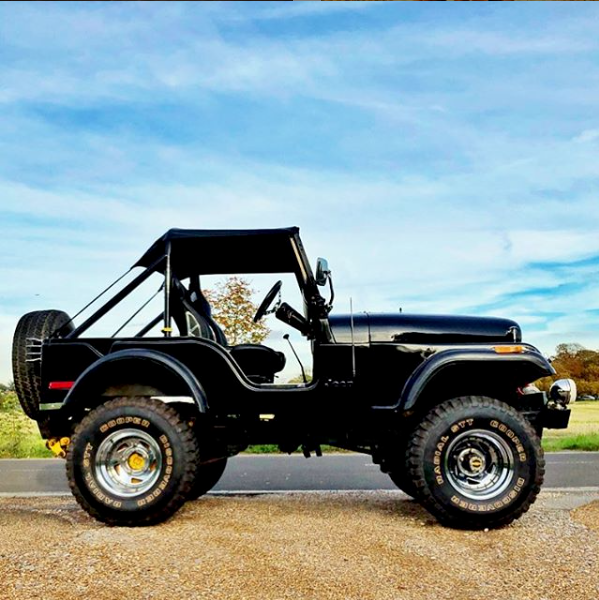

My goal is just about what you see here in this link. This Jeep is owned by a guy in Great Britain (don't know if he's on here). This is what I had been picturing my Jeep to look like in my head. He has a Rocky Road SOA kit, 4" spring lift, and one inch body lift on 33 inch tires. I want mine to look like that.
https://images-wixmp-ed30a86b8c4ca8...nf0l-2020bc96-7285-43b2-8675-d16415d6fb1b.png

I don't believe that jeep has SOA + 4" springs + 1" body lift. That would be about 10" of lift total. I'd guess either 4" springs + body lift or SOA, maybe body lift.
33s are about as small as I would consider with 33s, and usually don't see many with smaller than 35s. Also, its a lot of lift for narrow track axles. I would suggest going to widetracks, especially if you regear anyway.

The Jeep in the photo you posted is SUA 4" lift

Hmmm... thanks for all the replies. Maybe the owner of that pic took it before completing both lifts. Maybe he lied to me. I really don't know, but that is just how I want mine to look height wise and with those tires.
