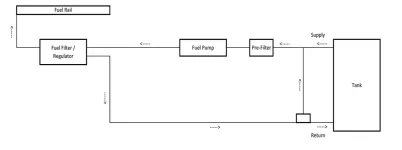

I've been researching a new, larger, temporary return line that would branch-off or "T" before it goes back to the tank. I'd have a branch that would loop back to the pump inlet. Appears some of the diesel guys are doing it to moderate their pressure. Just need to get rid of any air bubbles that may develop with such a loop. Haven't found too many who have done it and whether or not it will work. Something like the attached pic but it would also branch back to the tank return. Oh well.
Rough drew up what I'm thinking about doing for a temporary solution. Based off of similar systems for diesel and veg oil.
I'll have to keep air out of the system where the return line splits. Thinking about another fuel filter/regulator. Maybe the old one for the AMC 258 i6 / 4.2l will work?

Well, never mind. Got a different pressure tester that doesn't leak and the pressure stayed constant whether revving or idling so the return line isn't the issue. Only acts up when idling and in closed loop so going to replace the IAC.
