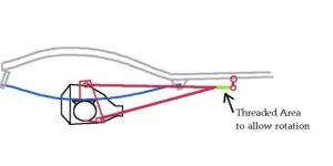

Rodger that, on the spring wrap. If you stick with a leave spring arrangement. You will need to solve that issue. Something along these line would do. 30448910011_large.webp
