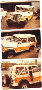

Blue Jeep with front cage and a hot 350 sbc rolled by a teenager on the street.

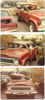

Red Jeep with front cage; rolled on the freeway while pulling house trailer.

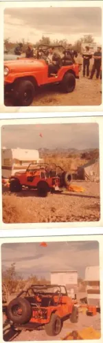

Rolled in the dunes at Glamis.
Driven home pulling house trailer shown.
Same owner of the other red CJ5 that rolled.
This 72 Jeep replaced the other red Jeep.
