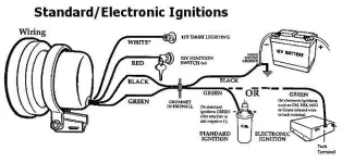

Very Generic wiring... Not sure how applicable to your rig / tach...
But the basic Principal is the same.
I've always hooked them up pretty much the same way no matter which vehicle.
Any chance you can take a pic of the back wires? Or how many / what colors you see coming off the back?
Not too familiar with your year jeep...
Hope this helps maybe a little... :cool:
