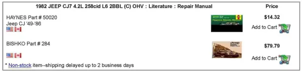

Bishko If it was me... I would spring for this one if you plan on doing a lot of your own work on it...
You may have to go through their "online parts catalog"... You (if you've never been there) just click start (on web page) Jeep / Year (82) / CJ7 / Literature / and check out the results...
Here's the parts list. You can see the diff in cost is great, but I'm sure you'd be happier with the more expensive one :cool:
