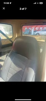

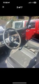

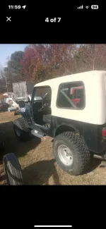

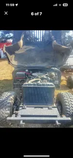

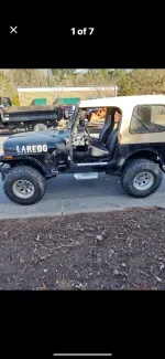

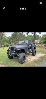

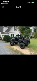

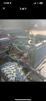

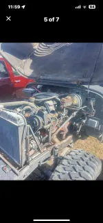

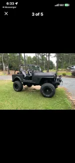

I see a few frame issues, missing skid plate under the gas tank and makeshift straps holding it in, body mounts look pretty rough, looks like it's also missing the front sway bar and connects. Still have the 2-piece axles in that rear AMC20 ? If it runs/drives OK and lights and gauges still work, maybe $7,500 IMO.
What is your plan with these? They both look like heavily modified project off-roaders to me. If that's what you're after, then here you are. If you're looking for a reliable daily, then this is probably not it.
With these, you are buying someone else's project and need to keep that in mind. In my opinion, they are not worth the asking price... just because they spent money on them, doesn't mean they're worth it. I'd want to know if the axles have been re-geared to match the size of the tires. Whether they're still running two-piece axles. A compression test on the "smoking" one. (A spare block to me, is worth about $100- because I will have it rebuilt- if it's any good- while I drive my smoker around.)
All-in-all, from my perspective, these are high priced projects that you will likely spend thousands on to either get them to your standard, repair all the things not done right, or both.
Figure out your budget. Spend a few minutes getting the details for these things and find out how much the "fixes" may cost you. Then offer the difference, since you'll have to spend that money to have what you want.
My honest opinion- the first one is an easy pass. Walk away. The second one I'd have a closer look at. It may be all cosmetic and no powertrain, but at least it looks like someone cared about it.

Thanks for your input boney. My plan is a trail, woods, beach vehicle primarily that will get driven around town only occasionally really. Needs to be roadworthy to get to local trails and the beach, but I will trailer if going up to Uwharrie or further for sure. My budget is about $15K at this point. Like I said I am more interested in mechanically sound rather than a spot free Jeep. I spoke with the owner of the last one I posted (the one with the long block) and he seemed to care like you said. I asked him for more pictures, but he said it was under a cover and covered from the snow they had last week. It is 2 1/2 hours away so I will want more pics before making a trip like that. He did state fervently that it was rust free and a solid vehicle other than what he told me about the motor and the steering box. Good point about the gearing though. Ill as about that. The drivetrain doesn't worry me as much as getting a solid rust free body and frame.
