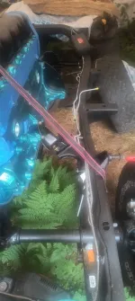

I am having an issue with the engine sitting in the frame on the mounts. The engine have a skew to it 1.25” measured by the side of the oil pan lip to the out side of frame. The measurement from the front of engine is 10.25” to the out side of frame at the back of the engine it’s 9” from engine to out side of frame the right side frame has the wide engine mount and the left the narrower one. Right side frame mount uses the out side holes the left side uses the forward 4 holes. Am I missing something? It looks like if I was to move the left mount back one set of hole the engine might site correct. Thank you for your input
