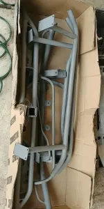

Ordered up their full timing cover upgrade with all of the goodies including nickel plating. Heat/AC arrived from JeepAir yesterday and the galvanizer emailed me to let me know the frame & misc parts are ready, so heading down to Columbus Friday morning to pick up. TBI kit from Performance Fuel Injection arrived today and the new tub arrived at Willys-Overland as well, so heading out to Toledo Saturday morning to pick it up. Picked up an unmolested engine bay wiring harness off eBay and I'm going to have the print shop at work print off some enlarged wiring diagrams for me so I can work my way through trimming & modifying it for my needs.
